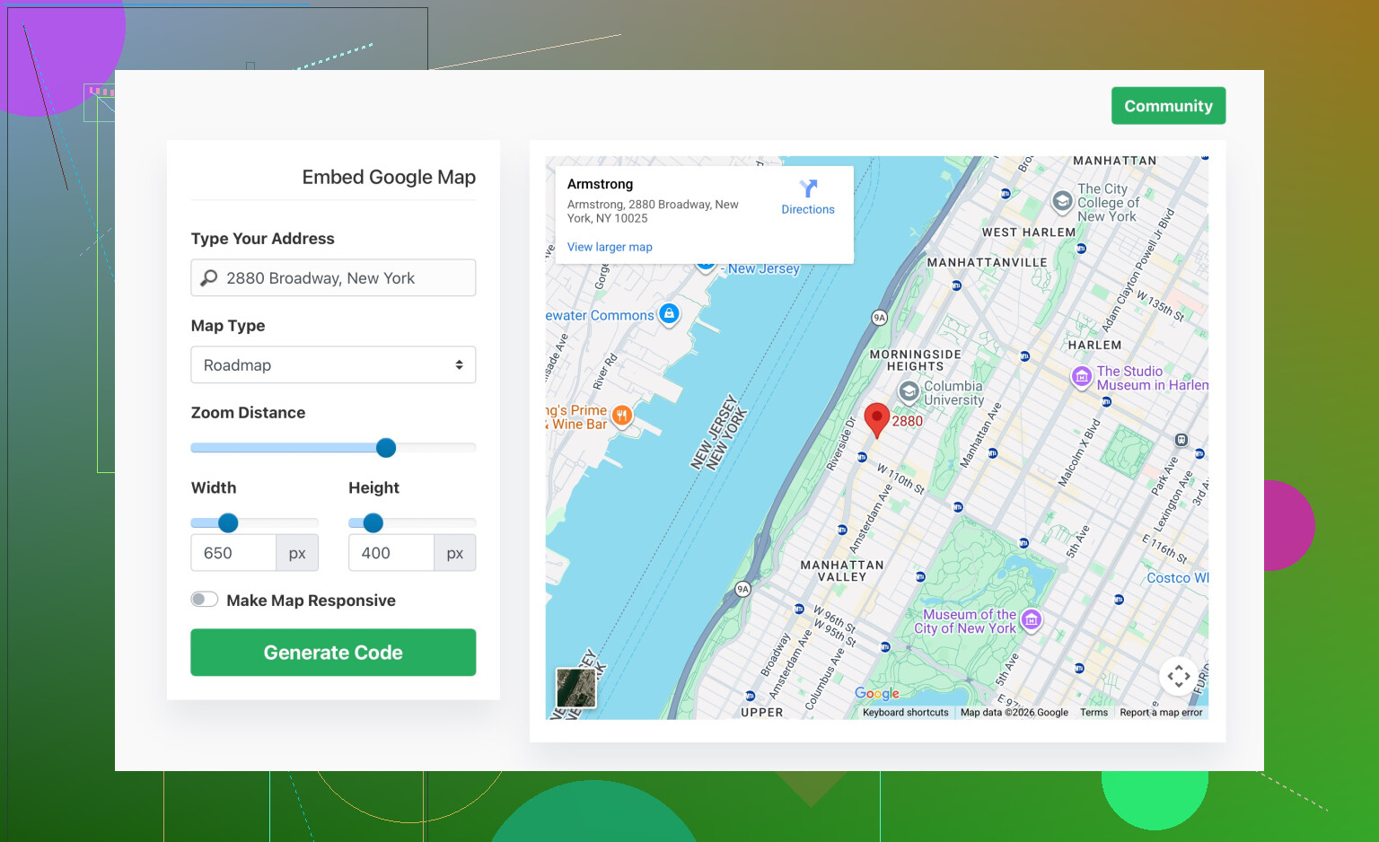

  2. If you want an easier method
    Instead of building the iframe by hand every time, you can use tools like
    simple Google Map embed code generator
    You enter the address, adjust zoom and size, then it outputs ready-to-paste iframe code.

6. If you prefer generated code
If you don’t want to fiddle with Maps each time or your editor keeps mangling the embed, tools like
create fully formatted Google Maps iframe code
can save some time. You still need to respect HTTPS and CSP rules, but at least you’re less likely to typo the URL.

6. About external embed generators
Tools similar to the unnamed generator that @mikeappsreviewer referenced can be handy, especially for people who hate touching markup, but they have trade-offs.
  • Save time if you generate many variants.
  • Often include responsive wrappers and copy-paste snippets.
  • Hide the messy pb parameter so you do not accidentally break it.
  • You get another dependency between you and Google Maps.
  • If the tool changes its template or adds tracking parameters, you inherit that.
  • Debugging becomes harder because your code is no longer the exact snippet that Google Maps issues.
If you use such a generator, keep a plain “original Google snippet” test page in your project so you can always compare and isolate whether the generator is causing odd behavior.
Competitors like what @mikeappsreviewer and @espritlibre describe (manual embed via Google’s own interface) are more transparent: less magic, more control. The trade-off is that you need to understand a bit more about the layout and security environment of your site.

If your map is blank, I’d bet on one boring thing before touching CSP or frameworks: the URL you copied is not the embed one. People grab the address bar link or the short share link and paste that. Those will never frame. The only thing that works is the string starting with maps/embed?pb= from the Embed a map tab. Everyone above said it, but it is worth repeating because it is the single most common cause and it looks correct enough to fool you.
One caveat nobody mentioned on the responsive wrapper trick from the first reply. The padding-bottom percentage hack works, but if you drop it inside a flex parent that already has align-items stretch, the height can go weird and you get a squished strip. Get it rendering with plain width and height attributes first, confirm the map is real, then add the ratio wrapper. Debugging layout and connectivity at the same time is how people end up blaming Google for a CSS bug.
